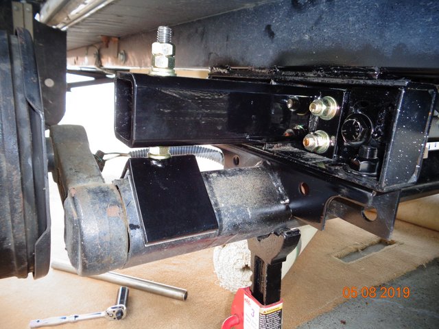

This is the problem with the way R Pods are built, your axle is 89.5 inches from center of hub to center of hub and 59.25 inches frame mount to frame mount = 15 inches of over hang on each side, the R Pod frame should have been about 15 inches wider making it only 7.5 inch over hang. If you call any axle company and tell them you are building a trailer with frame rails 59.25 inches apart and you want hubs 89.5 inches apart they well tell you don't do it. That is why I did this two years ago with no more problems. Here is how I fixed my 178, P.S there are easier ways to do it on this site.

This is how I solved my problem

You can see in my mods how I solved the problem.

Direct Link To This Post Posted: 04 May 2021 at 4:08pm
I really like your setup.  do you have a writeup on what you did? looks pretty straight forward.  Just have to find a place to order the metal.  Is the angle piece that pushes on the axle just angle iron welded to a threaded stud?  and is that just a 2" piece of square tube 1/4" thick that runs the length of the middle of the pod and then bolted to the custom made alignment stubs with the same square tubing bolted through the riser?

Looks awesome! I'm digging it.  My axle is actually bowed up in the middle under the center of the rpod and not flat.  I'm thinking it's exactly what you stated and that the edges of the axle have just bowed up slightly due to the mounting bracket location.  I was originally thinking of ordering a new Dexter axle and widening the mounting location with some 4" 3/8 thick angle iron and 3 big gussets.  but these fixes look a lot cheaper and potentially better as you have an added ability to adjust the camber.
