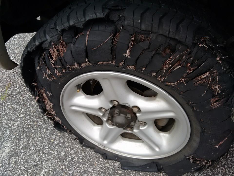

I do take the tire age issue seriously, and here's why. Tread dept doesn't tell the story.  This tire was a spare, on the back of my old SUV, for nearly 19 years -- original equipment, never used, looked perfect.
Then one day I had a flat front tire (sitting in my own driveway).  Swapped this spare into position. As I remember it, the spare was having a little trouble holding full pressure. I headed down the highway to a tire dealer to get everything looked at when KABOOM!
