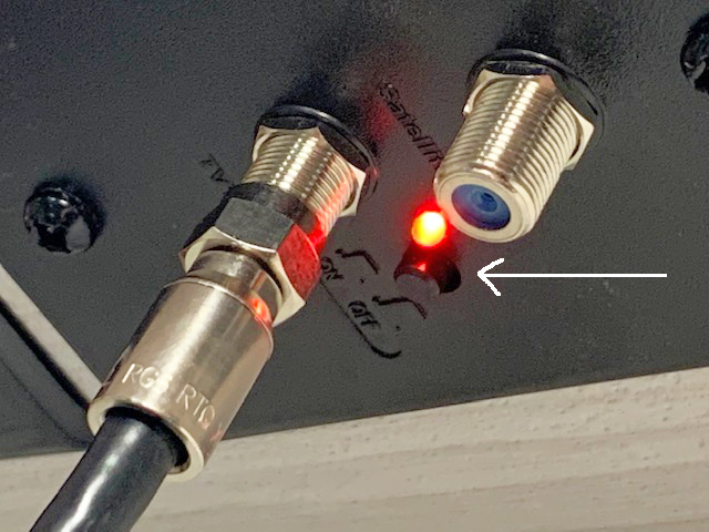

buffalohunter - I verified that toggling that tiny little button "Off" certainly did turn off the antenna booster on the roof.
The button is integrated into a cover plate roughly the size of a standard household outlet cover.  It has a bright red LED that indicates the booster is on.  Right next to the bright LED is the aforementioned push button.  Toggle it off, and the booster on the roof and the LED goes out.
Photo might help a bit.
If yours disappears into the ceiling . . .  then I wouldn't have any suggestions, as I definitely am a noob to the RV thing.
