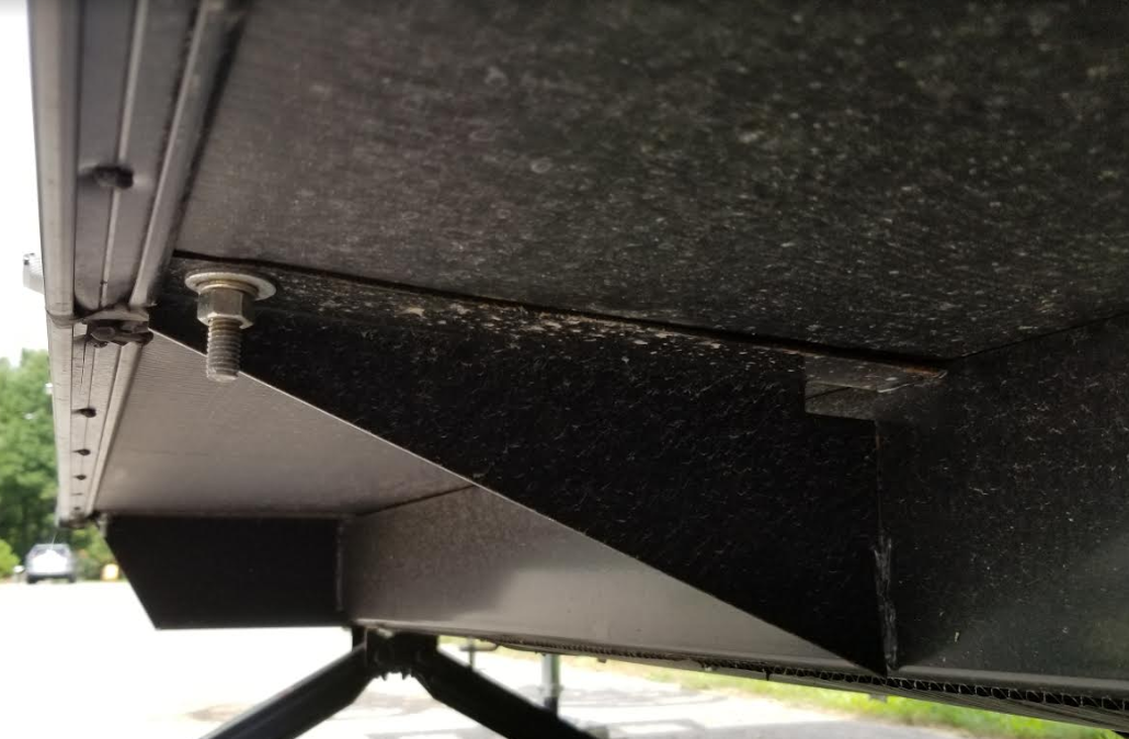

My 195 has outriggers on it, due to the wider width. Each "gusset" is about a foot long. It's tack welded to the frame and extends to within an inch of the edge. The edge that is up against the floor has a 90 degree bend to form a flange. From the end it looks like a letter T, with onlt half of the T crossed. Then right out at the edge of the camper, they bolt the floor to the flange section. Each "gusset" is about 34 inches apart om mine, so I would think (based on their normal meeting of minimal standards) spacing them out about 24 inches would be a good solid base.

Would you mind posting a close-up picture of one of the outriggers? That would be helpful.

Post Options Post Options   Quote mjlrpod Quote  Post ReplyReply Direct Link To This Post Posted: 30 Jul 2020 at 1:23pm
Hopefully this works. Now remember, I have a 195 so my outriggers are a couple inches longer than yours might be.

Posts: 6422
Post Options Post Options   Quote StephenH Quote  Post ReplyReply Direct Link To This Post Posted: 30 Jul 2020 at 2:16pm
Thank you. That is very helpful.
