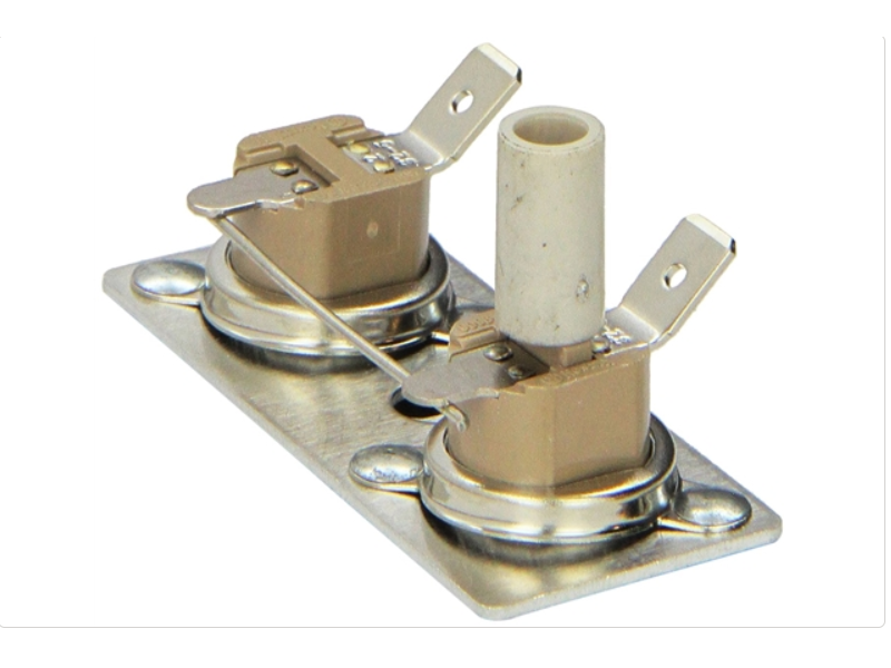

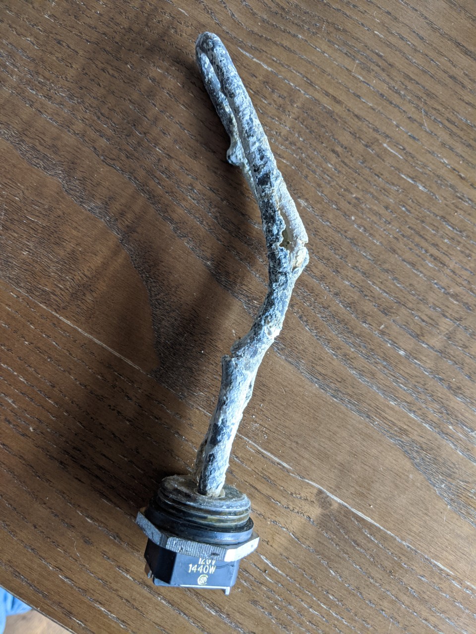

Could not under any situation detect any hot skin voltage. Nothing. Took every test I could think of. So, was thinking it was maybe the campground power... Then tried out with the heating element test. Nothing. Could not detect anything so removed it (see picture) and replaced it. Was hoping all would be done after this... ![]() ...but as it is with my life...no such luck. Drove me crazy after that point...was getting no power at the element terminal, but there was 120v at the switch. Taking voltages at so many points I finally figured out behind the black rubber "reset" pad there are two sets of thermostats/high limit switches (or some other protection device). They look look like this....the propane side is fine...but the AC side is fried. The "wire" shown between the two terminals is cooked in half. ![]() So...another part to order...but at least tracked it down....I think. So, the "hot skin" problem still not 100% solved, but I can't seem to re-create it...so likely a combination of the water heater element and/or campground power...or both. Will update when fixed once and for all... |
