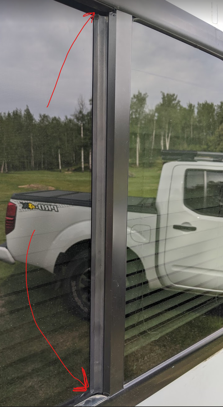

So, on our "test" camping trip we did, we noticed a LOT of mosquitoes were getting into the trailer.  Actually turned into a sleepless night of bug killing and blood sucking.  Looked like a murder scene the next morning...Shocked
Anyways, I think I see where they are getting in....the seals on all the windows look like they have shrunk over the years, and when you open the window all the way, this creates a gap in the corners...any bugs crawling on the screen can get in on the top or bottom corner.
I think leaving the glass closed about 1" will solve the problem temporarily (the round corners on the glass creates the gap) but are those seals replaceable?

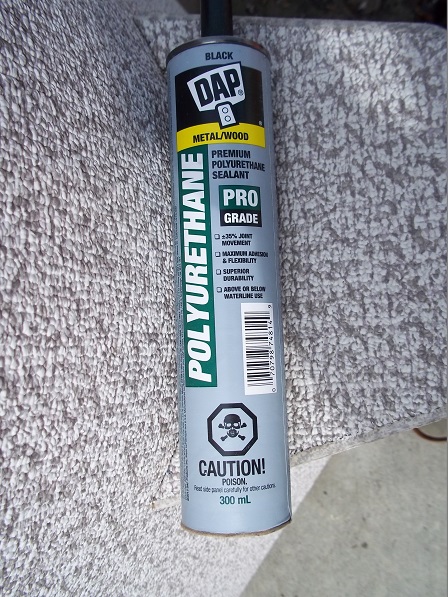

Fill the gaps with a little bit of sealant? Dow makes a black, rubbery sealant that stays flexible and seems to work quite well. I'll have to go get the tube to post the information since I don't have it here with me.

Would the RV place have the sealant?  I have to pop by there later anyways.  How would you apply the sealant without sticking to the glass?  Any ideas?  Or perhaps apply it, and then slide a razor blade underneath afterwards to cut the bond?

I am 90% sure it was the windows....I could easily see when I opened the windows right to the hard limit, it left a significant gap near the corners....any critters crawling around the screen would be likely to find it and get it.
So, hopefully, between leaving the windows open at 90%, the polyurethane (I applied yesterday) etc. the bug problem will go away.

So, thanks for the polyurethane tip.
I pushed the seal right up to the top on each window, used a bit there (to seal and hold it in place) then cut a small piece of black plastic to keep the polyurethane from the glass, and seal up each bottom.  This is a bad picture (but you get the idea).  It looks sloppy here...but is actually barely noticable unless you are right up with you nose to the glass.
Grant
2011 R-Pod 177
Posts: 6437
Direct Link To This Post Posted: 06 Jun 2020 at 5:54pm
Looks good! It should hold up well.
