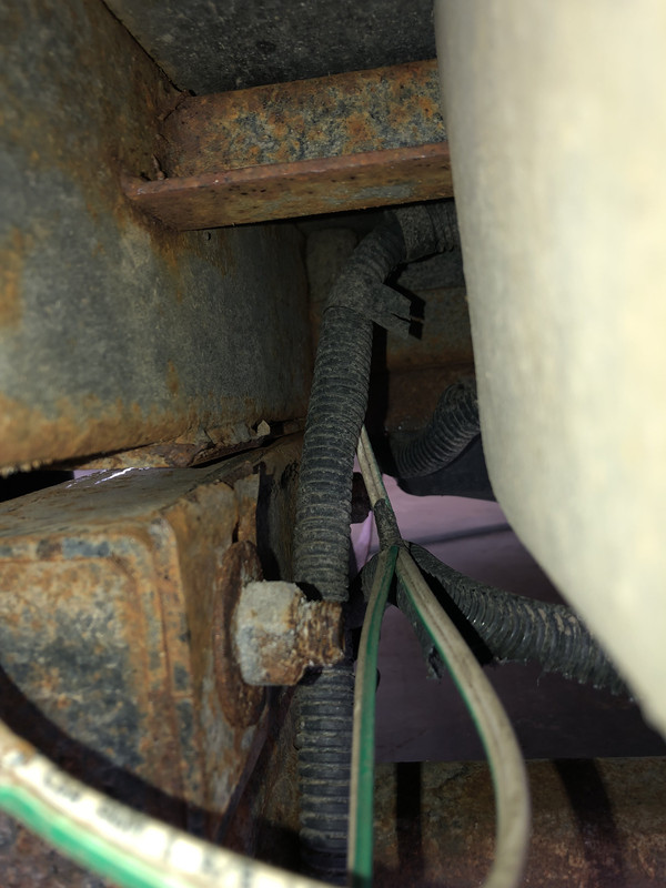

This shows the break, I hope. Note the condition of the bolts.

Bolt appears rusted, but intact. The bracket weld to the frame looks incomplete.
Direct Link To This Post Posted: 09 Jun 2019 at 5:34pm
+1. It’s hard to make out but it looks like it might be a poor weld combined with corrosion. No sign of movement due to loose bolts that I can see.

+2, the weld appears broke. Heavy corrosion.

I don't pretend to be an expert.
I believe the break is in the metal tab, due to metal fatigue, just before the weld begins.

Yeah it looks like the welded angle piece broke due to rust and fatigue at the bend. It appears to be thin metal, undersized for the job. I believe mine does not have the bend, it is welded as a flat piece along the inner surface of the main frame. I will look at this today.
Can I ask what part of the country this trailer has been mainly operated in? Are we looking at a north-eastern tier 'rust-belt' casualty?
From what I can see, the entire frame may be in danger of breaking in half. Shocked
{edit: I looked at my axle mounts and they are made the same way as yours, with those 'tabs' bent under and welded to the frame.}
