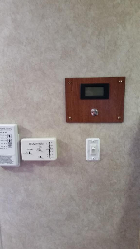

We have just installed an actual voltmeter. In the Pod, I wired it into the bath light circuit, that means it reads just a hair low, due to line losses.. but that's a good thing in my opinion. We added a whole panel of 12v goodness in the new camper. While I like some of the features of it, it only reads in 10ths, and it's voltage monitor is on all the time. It's inside a cabinet, so it isn't a light pollution issue, but if it "on" it's wasting so mA's.. LOL "you can take a camper out of the boondocks..."
Rpod.. I think the monitor and push button was about $5 on Amazon.
