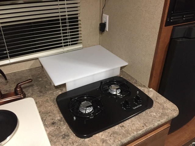

here is what i did and we are pleased with the outcome.  I used HDPE cutting boards from Sam's, about $8 each i think and comes in a two pack.  fits between wall and stove top when cooking.
TexMan 2015 182g
