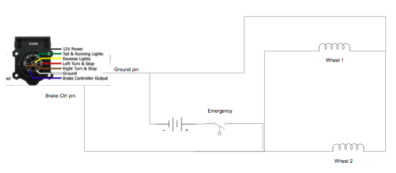

Thank you all. It is not under warranty. I had a quick look under the frame and saw a couple of places where the insulation had gotten hot. So I was thinking to basically rewire the whole thing so not to miss any possible degraded insulation section. I think if I could get a wiring diagram it may be easier to do that. What do you all think?
Direct Link To This Post Posted: 03 Dec 2018 at 4:56pm
It is literally just a straight 12v circuit. Nothing tricky about it.

The brakes are two wire, and it doesn't matter which wire goes to where. Some diagrams show a blue wire and a ground. Get rid of any short areas and wire it. There is no 12V and ground side at the brake. You can hook them up either way. Pretty cut and dry.

The short must have been in the wires coming from the emergency brake switch because it all started smoking when that pin was pulled? uhm....

The short can be located anywhere in the brake wiring. When that breakaway switch is activated, it sends maximum amps to the brakes. It's job is to stop the camper as fast and hard as possible, in case it has become unattached. So it energizes the entire system fully.
So you have the wires coming from the battery to the breakaway, the wires from the breakaway to the brake wires, the wires running to the brakes themselves. As noted above, the wires coming out of the brake housings are polarity blind. It's just a simple electromagnet, and the current can run either way through them. So start at the brakes themselves, and start following/tracing/checking the wires back towards the front of the camper. Replace or repair any wires that look iffy or are damaged.

Very much appreciated! So the brake controller pin must output different voltages from the brake controller... learn something new every day.
