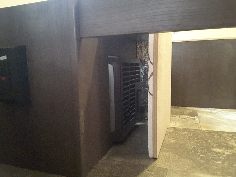

On the redirection mod for heater, what is the material coating the inside facing wood?

Insulfoam by Carlisle is the lining for the inside of the wood.....I have not used the heater yet. Am I setting my myself up for a hot mess? I don't plan to use the heater for extended periods of time and plan to keep a close eye on the surface temps but I surely don't want to burn down the "Grimpod"?..........All opinions are welcome?.....

Originally posted by grand beaver
....I built an air deflector for the heater.
From the front.
Okay. Be cautious about this. If you take the front off of the heater, you will see that the area on the lower-right is an air return. In fact, the whole area around the front of the heater is air return. By putting your box over it, you are restricting airflow so that the hot air output of the heater is pulled right back in. I think you will have problems unless you find a way to allow for cold air return.
What I did was to get a RoadPro RP8000 fan. I put a 12V outlet near the AC outlet, and plug the fan in there. I can also use 8 D-Cell batteries if I want to instead. This sets at the base of the bed blowing outward. It pulls the heat from under the bed and sends it out to the rest of the R-Pod. Since it is not blocking anything, it allows for cold air to return. It is small enough to sit there and not be a trip-hazard.

Thanks StephenH........I respect your opinion as I have read many of your mods and know you know the pods well. I will consider putting some kind of fan behind it. I didn't even consider the air intake for the heater! Our upcoming trip to Boise and The Sawtooths will all be in KOA's with full hookups so I can run a "cooling" fan to push the air around the heater....Thanks again for the input!
