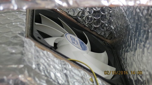

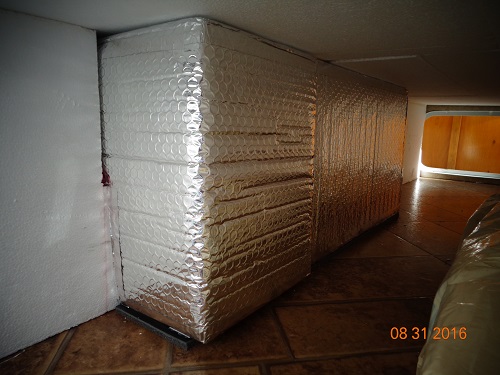

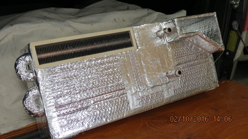

My pod now has a new heating system: Hot water heating. I made a heater core, HWT doubles as boiler also put in 2 computer fans and an inline water pump. It's super quiet, only draws 1 amp, I'm very happy with it.

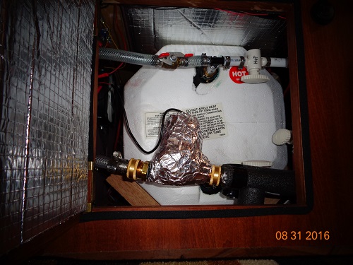

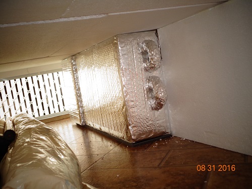

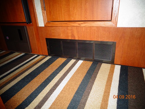

 The heater is thermostat controlled, I can bypass the heater core by closing 2 valves in and out of the HWT. I can also switch off the pump or the fans. The nice part about that is that I can run the fans just for air circulation. The air gets picked up through the vent under the shower, therefor I made the hole
bigger. The big silver blob you see in front of the HWT is the inline water pump. The heater itself is in the outside storage.
Online Status: Online
Posts: 6417
Direct Link To This Post Posted: 01 Sep 2016 at 9:08am
Let me see if I am interpreting the picture correctly.
1. Hot water from the water heater is piped to your new heat exchanger to heat the air.
2. Cool water returning from the heat exchanger goes to the pump and is returned to the cold water line to go back to the water heater.
3. Thermostat controls operation of the pump and fan. Fan can be switched independently to operate if heat is not needed.
With the 179, I added a divider, making a small compartment into which I could install such a heat exchanger and not have it in the exterior storage. That is limited enough as is since it does not go all the way across in the 179. My air return would also have to be different. The remaining questions I have are parts questions. What pump did you use for this? I am going to have to assume it is a 12V pump. What thermostat? For the heat exchanger core, what did you use?
