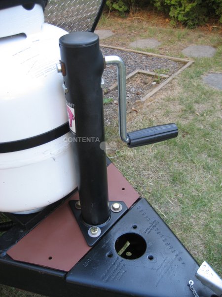

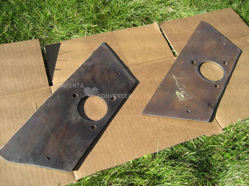

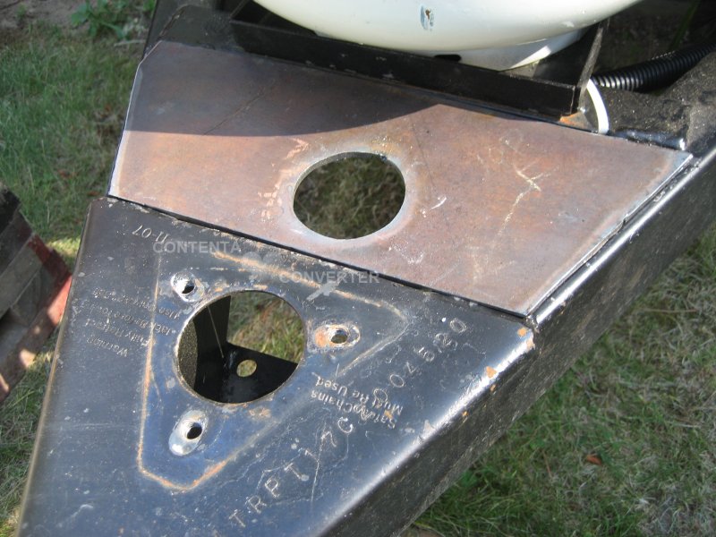

Not hard to move the jack. I made a couple of plates to sandwich between the frame. I used 3/8 inch steel plate and cut a hole for the jack in both of them. I turned the jack 1/3 so handle would clear my one tank, and moved it a tad to the port side. Used best quality bolts to support the jack, the weight will be held by the bottom plate, so the top plate could be thinner material. Used self tapping bolts to hold plates in place. I think you could make paper templates and have someone cut them for you. It would be easy to convert back if necessary.
