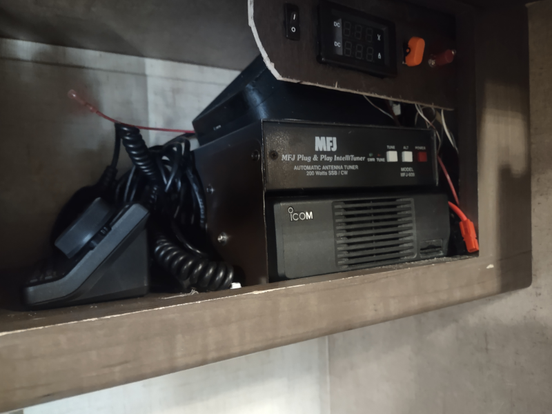

They are BNC connectors. I used BNC because they are waterproof when connected and the caps make them waterproof when they are not being used. They are also easier to connect and disconnect than the PL/SO connectors. The connector to the left is a 4-conductor connector for the AH-4 antenna tuner. I guess I need to put a picture of everything set up and connected.
The bottom connector is for the HF antenna. The top connector is for the VHF/UHF antenna. Since I travel with an Icom IC-7100, I only have to carry one transciever.
Posts: 6417
Post Options Post Options   Quote StephenH Quote  Post ReplyReply Direct Link To This Post Posted: 18 Apr 2022 at 10:23pm
I still have not gotten a picture of the setup with antennas, but I did get the radio and tuner as well as a switch panel and LED light strip mounted. These came in a go-box that was just too big to fit in the RPod. The go box is in the house holding a power supply and other accessories for the radio inside.
The radio is an ICOM IC-7100 and the tuner is an MFJ-939I I also have a Motorola speaker mounted (after the picture was taken). It works pretty well, although the real test will be how it works when we travel.
I do not show the antenna or tuner cables connected. The good thing about the head unit is that it connects via a cable and can be moved along with the microphone when in use, then stowed when not needed.

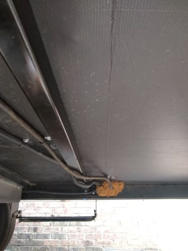

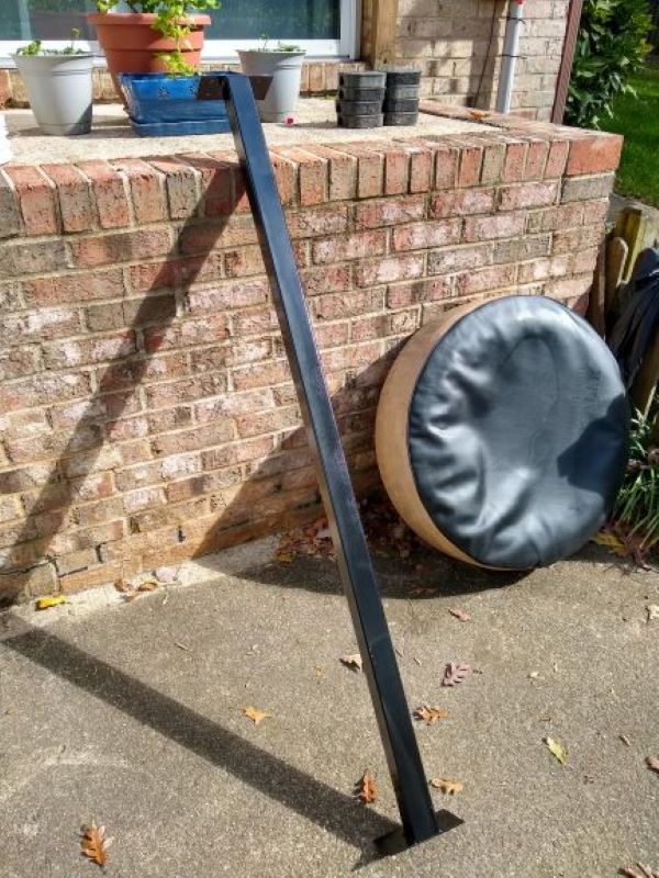

A followup to StephenH,  Installed the bar under the floor of my 179,  although my floor was not having a sagging issue,  it always seemed a bit soft,  after installing the bar it is very solid,  it was a good investment.  Simple design, measure between the frame,  the welder subtracted 1/8 inch to allow the bar to be maneuvered into place.  there was 1/4 in difference between StephenH's bar and the one for my pod and as he said  no two pods are the same! I installed it 15 in from the grey water tank support, just to the right of the left door frame.  Thankyou John Marrucci,  although you went through a fair amount of frustration with FR,  you posting has helped a great deal.
What size tube did you all use??

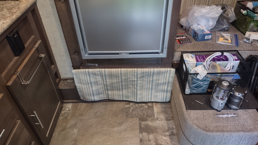

Here is a real quick one. How many RP-179 owners have been frustrated at the panel below the refrigerator that keeps falling off? I know I was. After our last trip where it fell off again, I decided enough is enough.
I took a piece of the fabric that I used for making the dinette modification cushions. My wife used her serger to serge around the edges so that it would not unravel. I then took a thin board about the same width as the aluminum frame under the refrigerator. I stapled the fabric to the board on the back side of how the fabric would hang, letting it fold over the top and hang down. Three screws hold it in place. It covers the unsightly lines and pipes and will allow easy retrieval if anything should fall down there again (as it has in the past). Being fabric, I won't have to worry if it hits something as the slide is being extended or retracted either.
