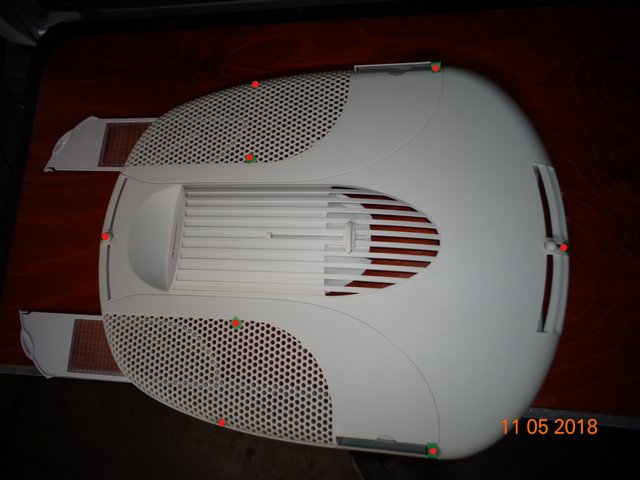

Does anyone know how to remove the plastic ceiling cover for the AC on the inside of an R-Pod? (photos are from our 2014 R-Pod 178)
Our latest camping trip we encountered a steady downpour for many ours, and at one point water started to drip from that plastic housing. I tried to gently tug on the plastic but it wouldn't release, and I didn't want to yank it off. Any suggestions on how to remove this without damage?

I don't have a picture showing the screw locations, but there are multiple screws holding it up on the inside. Look carefully with a flashlight, and you should see the screw heads. Check behind flaps around the perimeter and in the perforated area. They are not hard to remove once you find them. If I remember correctly, there are 8 screws that you need to remove. You may wish to use the advanced search and see if you can find the picture I mentioned. With the advanced search, you can search posts older than 6 months.

I found a previous post related to how to remove ceiling cover. The original post is titled "Air conditioner leaking when on" dated July 30, 2021. You replied to the post with a photo with screw locations. I will give it a try. Thanks for your help!

I took the inside cover off, couldn't see any sign of a leak (of course it isn't raining now) and snug tightened some bolts. Next I'll take outside cover off and check roof, caulking, and drain. I'll post my findings to this chain.
