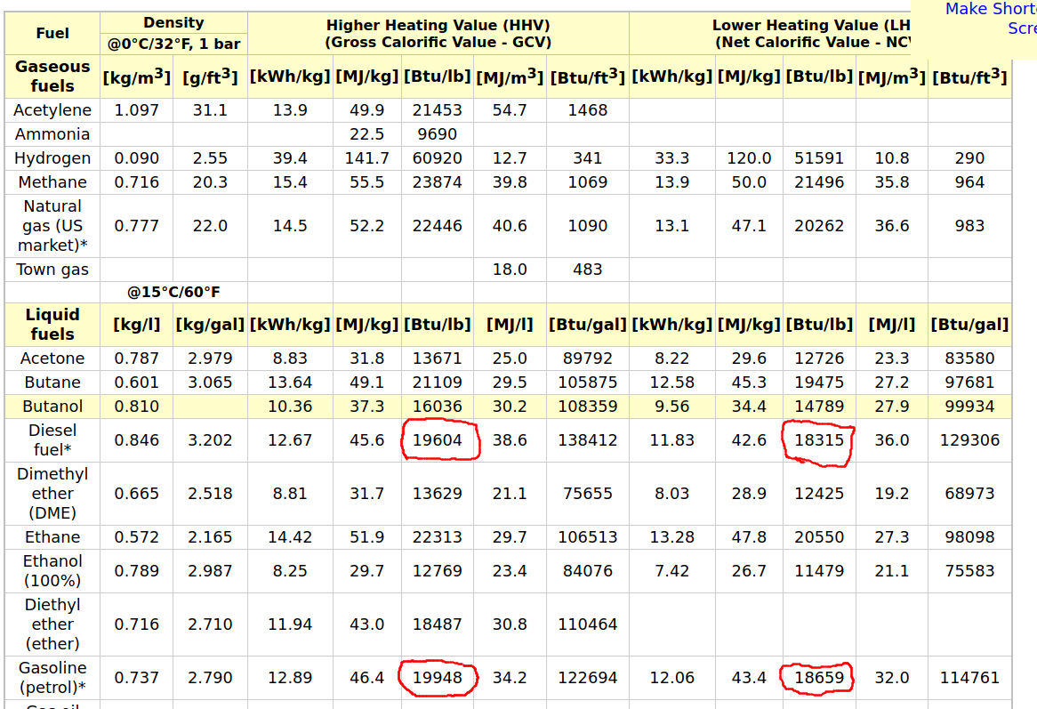

You can’t directly compare diesel and gasoline fuel economy though. Roughly speaking, diesel contains about 15% more energy than gas, costs about 15% more, and produces about 15% more CO2 per gallon. So you can get a pretty close comparison to gas if you reduce diesel fuel economy by 15%, which is about 2 mpg towing, 4 mpg not towing. |

Offgrid, That's sure a lot of effort to run down diesel. Diesel IS more dense than gasoline, but the BTU content is not significantly different, with a slight edge to gasoline. Combustion occurs on a mass basis, so comparing BTU/lb or kg makes sense. The attached pic is from engineeringtoolbox.com ![]() |

Mark Twain said it: There are lies, damn lies, and then there are statistics.
The fact is, we don't buy diesel or gasoline by the pound, we buy it by the gallon, and...by the gallon, diesel has about 15% more BTU per gallon as stated by offgrid, and showing in the chart. Diesel can cost 15% more, or sometimes as high as 50% more per gallon depending on the pump prices in effect at the time. Then figure in higher maintenance cost for the diesel engine over its life, and DEF, etc, the differences are not that significant for light trucks and commuter cars. Certainly, the higher power that turbo diesels produce IS a huge advantage when pulling trailers.

That chart is slightly misleading. We fill our tanks by the gallon or liter, not by the pound. Therefore, it makes sense to calculate the energy per gallon or liter, not per pound. The chart is best interpreted then by looking at the right hand column. Gasoline has 114761 Btu/gal and Diesel has 129306 Btu/gal.That means that Diesel fuel has 112.68% more energy per gallon than gasoline or put the other way, gasoline has only 88.75% of the energy of Diesel per gallon. What hurts gasoline also is the Ethanol blends. The figure I saw stated that 10% ethanol blends have only slightly over 96% of the BTU value of straight gasoline. That makes the difference between Gasohol and Diesel even larger. This Gasoline Gallon Equivalent Table provides a pretty good picture of these relative values.
