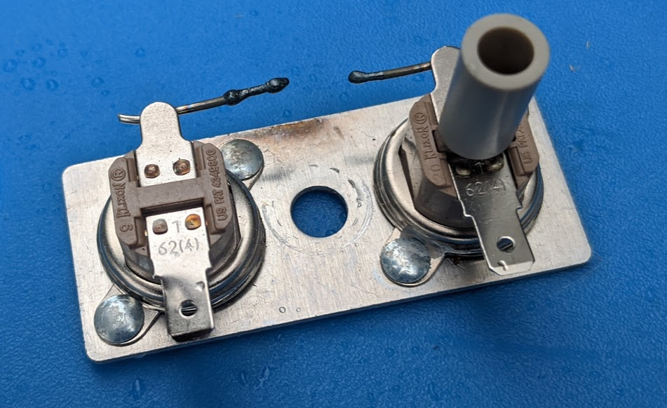

So, this was the next piece of the puzzle (after replacing the heating element and still not heating).
....so, after replacing that with a new one, plugging in the trailer, I was getting heat...YEAHHH!   And still no detectable trace of any power going to the chassis.
So, after getting it all back put together, I go to turn it OFF, and guess what...the AC power switch in the water heater compartment also appears to have fused now....cannot turn it off...sheesh...what next.
So, turned it off at the breaker and have to replace that next...
Whatever cooked the element appears to have done a job on the entire water heater electrical system.

The element was probably run without water in the tank at some point. It then overheated and created a resistive fault to the tank (and therefore to ground. Resistive because if it was a dead short it would have tripped a breaker in the trailer panel. But the current flowing into the fault was sufficient to eventually cause the poppet thermostats and the switch to overheat. That is interesting and a bit concerning because those items should be able to handle the current flow. I'm becoming suspicious of the water heater breaker in your trailer panel.
I would also still confirm that you have a good ground connection between the chassis and the ground pin in your power inlet. That is very important to assure safety. You don't want to be working on this stuff with the chassis hot.

Just did another round of testing today (as I was at the trailer and replacing the AC electrical switch for the hot water heater which had fried during previous events).
I've still been unable to replicate any electrical fault since the original electrocution event and after replacing the heating element, thermostat, and switch.
Tested resistance from numerous AC electrical ground locations (ground plug on various AC plugs, inside and exterior, ground bar in fuse box, and copper ground wire coming from fuse panel.
In all locations, resistance from chassis to ground location was always under 1 ohm.  So, all I can really say is that other than blaming the camp ground voltage supply for an improper ground, my FIRST thing I'll be testing EVERY time I plug in the trailer is electricity on the chassis...

i ohm is good. It seems like you are probably good to go now. Use either an RV circuit analyser or as a minimum an open ground detector anywhere you plug in. I've only used the non contact testers to identify hot wires in a bundle (because you don't need direct contact through the wire insulation) but they ought to work fine to detect a hot skin condition. Note that they only detect AC voltages, so you can't use them to determine if a wire in your 12V system is hot or not.
The remaining puzzling thing to me is why the switch and thermostat assembly in your water heater failed. In theory the breaker in the trailer panel should have prevented that. Maybe you at one point encountered a campground wiring system where either the ground or neutral was hot which might bypass the breaker entirely?
