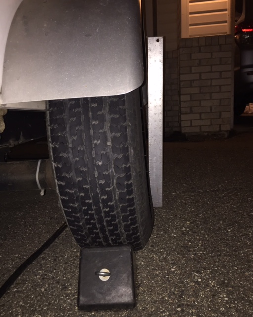

Update. After lots of calls with Forest River, Lippert and my trailer repair shop, I'm replacing the original axle with the OEM from Forest River. Couldn't get a replacement with a higher weight limit without changing the lug pattern. I just bought new tires last fall. Gave up and went back to the standard 3500#. Just going to have to mind my total GVWR more carefully. Funny thing was, the price for FR was over $100 cheaper than Lippert! And FR orders it direct from Lippert!  Regardless, parts will be here in 10 days or so and we'll be rolling on straight wheels again. Had them throw in a replacement fender for the one I banged up dropping a kayak on it last summer. Can't wait to be all shiny and new again. Gonna get after all the interior/exterior calking next.

Thank you D & D. Do you have part numbers for the replacement 4500# setup? And pictures? Would be helpful. Started looking for replacements and seems like there's a ton of options and variables.

Our Vibe which originally from the factory had a 3,500 lb. axle and was changed later under warranty to a 4,500 lb.axle. It was a Lippert axle replaced with a Lippert axle. The r-pods I think have been built from the factory with either a Lipert or a Dexter axle. Both the r-pods and Vibes have the same axle and fender design. The only thing that may be a concern would be the strength of the frame the Vibe has a stronger frame from the earlier model r-pods. I don't think the frame on the earlier model r-pods would have a problem with a 4,500 axle but I am no expert on frames. Marwayne has added a lot of weight to his earlier model r-pod I am sure he could be of some help.

We have a 2010 RP-172t. Last summer I noticed excessive tire wear on the insides of both tires. Not bald but much more than the rest. I replaced the tires but now see the sit with a tilt in toward the trailer at the top. See pic. I can't get a good pic of the axle. I suspect it's been overloaded and bent past 3500# limit. Not currently loaded in this pic so I bet it's permanently bent. We travel w/ water plus a bunch of supplies and bikes for 4 on the back. I'm reading we should fill up water at the destination and maybe move the spare tire to the truck. Has anyone upgraded the axle to a 5000#? I'm replacing the OE this spring and would like to know if it's possible/recommended.
