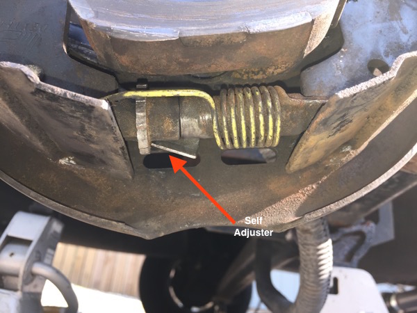

Good observation Podster and I should have explained. I did close that adjuster. It was about 4 or 5 turns out and I adjusted it to "just a bit of drag" when I put the wheel back on. I was messing with the adjuster to see how it worked. Great observation!

Fred, that auto adjuster in the pic doesn't look like it have every moved. Some folks are going this way.

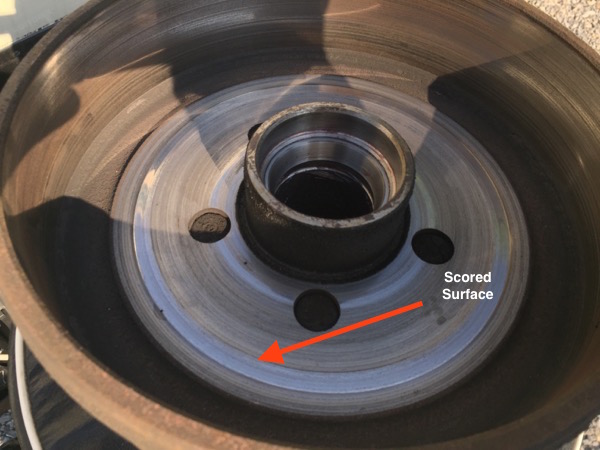

Direct Link To This Post Posted: 25 May 2015 at 5:32pm
Here's a few pics I took when I pulled the drums a couple of weeks ago. Dexter Nev-R-Adjust.

Podster, I don't have a lot of experience with auto adjusting brakes and my last experience messing with drum brakes was on my 68 Dodge Dart.
That said, I like taking things apart and trying to figure out how they work.  The whole self adjusting mechanism looks a little funky to me. I did watch a ton of You Tube videos and stayed at a Holiday Inn Express, so I figure I'm a espert now! Wink
Not ready to put disk brakes on the pod just yet until the water rises a lot more. If you did have to replace assembly and drums, my guess is you would go for the non auto adjusting assembly?
Maybe we should move this discussion?
Edited to add: Don't want to alarm anyone. Especially new buyers. My Pod has performed wonderfully and taken us all over the US. We probably have an unusual number of miles on ours for a 2014. Just trying to keep it going for another unusual number of miles!
