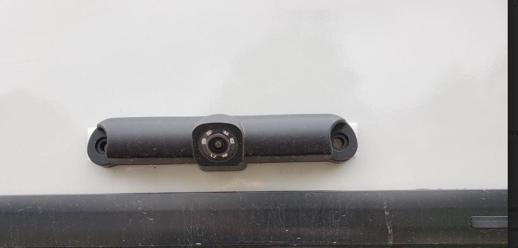

I installed my camera the same way on my 190. I have the 7" monitor now. Although a larger screen the resolution is not as good. Also the picture seems to cut out which it did not do before. Does your do that?
This is a replacement camera and display after the first one filled with condensation. I take it off after every trip now.

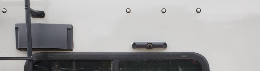

How and where did you mount the QuickVu camera. Just received it a few days ago. Any help and pictures if possible would be great!
I used 3-4 1" velcro squares to attach it slightly off center (oops) just above the rear window on my 195.  The squares don't cover the screws on the back so replacing the batteries shouldn't be a big deal.
It has survived a couple of trips, including one that included a rough-in-spots gravel road that caused the pocket door to fall off.  Seems to be on there for the long haul.
