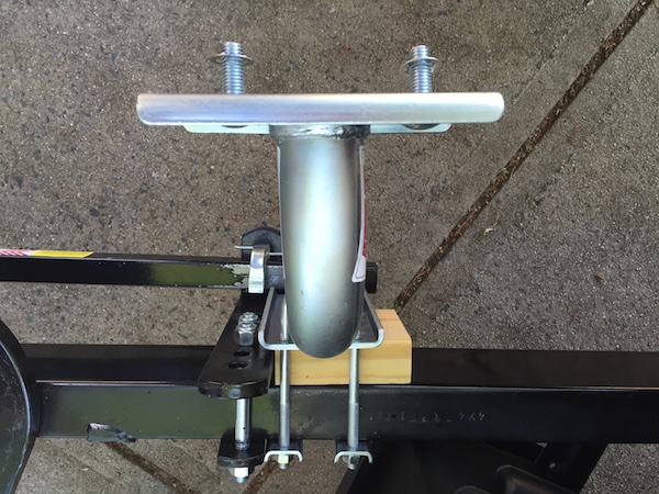

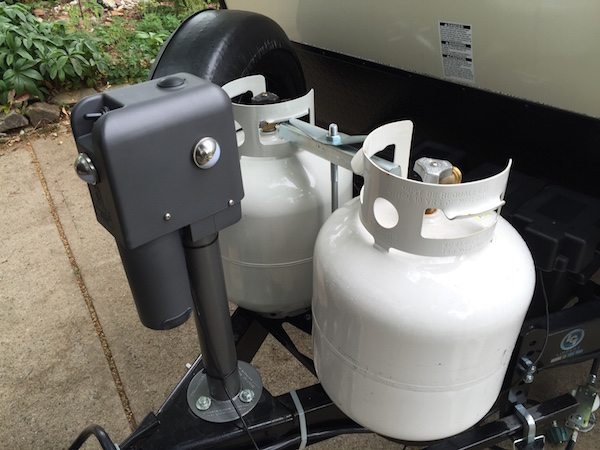

I just completed 4 mods to the tongue of our new (to us) 2015 178:

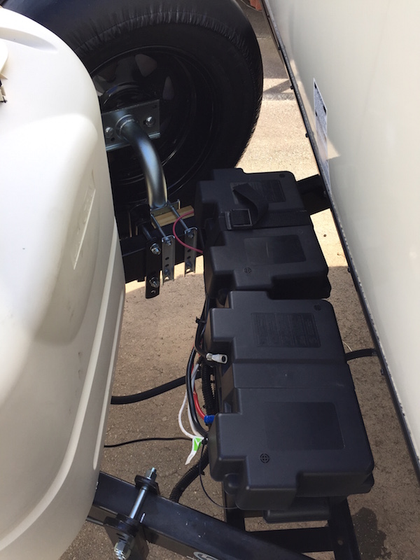

1- Added 2nd deep cycle battery
2- Added 2nd propane tank
3- Added Husky 4500 power jack
4- Moved spare to tongue so I could mount our bike rake on back
Pretty basic, battery box and new deep cycle connected in parallel.

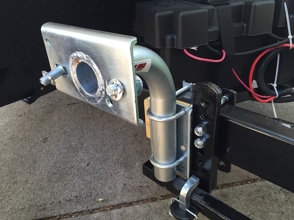

I cut off the original single tank holder with an angle grinder and bolted this on using the 2 original holes thru the frame. I added 2 more bolts thru the angle iron cross support.
This i where I bought the dual tank hardware:

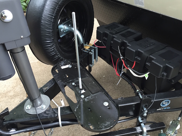

I bought the Husky 4500 from Amazon. Easy install - left the trailer connected to my Xterra. Removed the old hand crank and bolded on the new. One wire to battery:
This was a great find on Amazon and works  great! Now we have room for our bike rack on the back of the trailer.

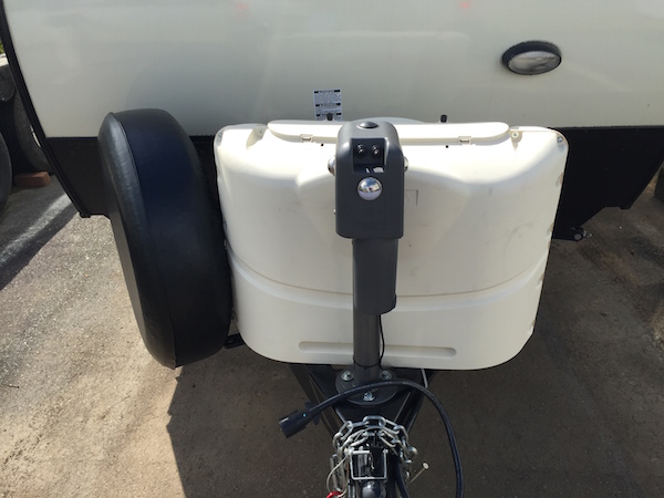

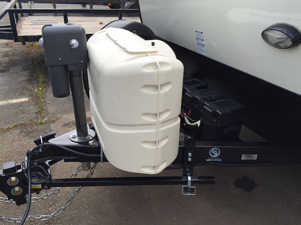

I did add a 2x6 spacer block to move the holder out some from the frame to make room for the 2nd propane tank and cover. I need to paint it black.

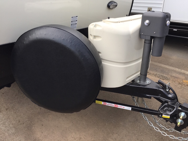

I did buy this tank cover from Amazon as well (if Amazon doesn't sell it you don't need it)
It comes in beige to match the trailer.
I did have to offset the propane tanks a few inches to accommodate the spare tire.
IT looks great!

Really nice job. It may just be the perspective of the photo but it looks like the Equalizer torsion bar under the spare tire would be a pain to access to get in place.
Jerry & Cathy
2015 RP-179 HRE
2013 Tacoma SR5 4x4
Direct Link To This Post Posted: 10 May 2015 at 8:56pm
It's actually not bad at all.

is there any clearance issues while turning with the spare on the tongue?
Direct Link To This Post Posted: 11 May 2015 at 8:03am
None whatsoever; not even close.
