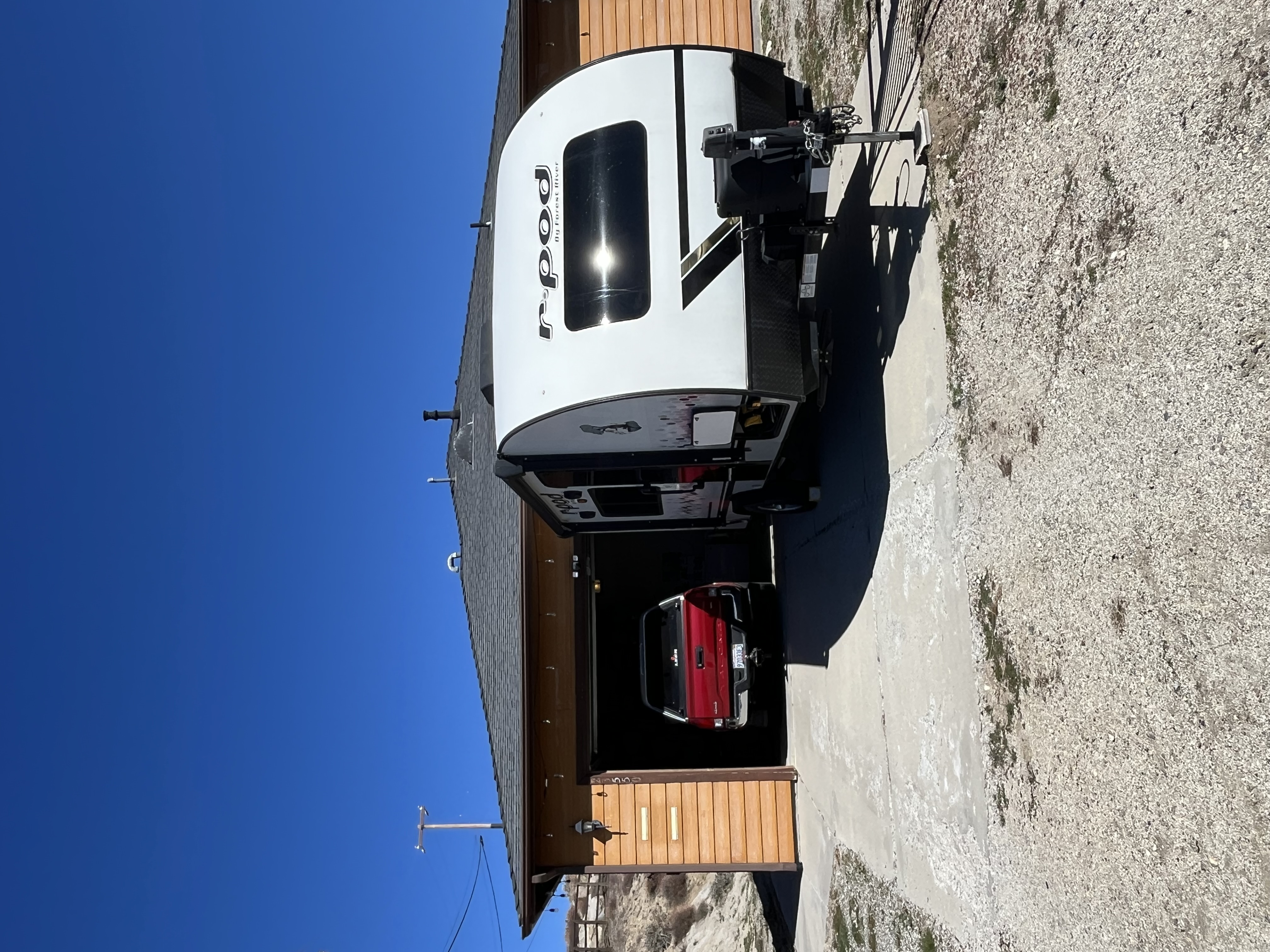

I just got my brand new (to me) 2021 RPod 192 home.  I live on top of a mountain in SoCal and 5 inches of snow are forecast this Sunday night.  Then rain and snow for about 5 days.  Temps will range from a low of 29F to a high of 46F between Sunday - Thursday.
I emptied the tanks yesterday but then filled the black tank with 3 gallons of water bc a friend said "NEVER LEAVE YOUR BLACK TANK EMPTY'"
I did not purge the lines yet but I will do so.
I did not use the shower but I assume I should turn on that faucet too and will do so today
Tonight my BIL will help me put a cover on her.
What else can I do or should I do?????
